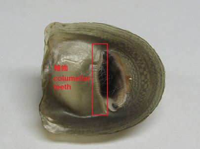

再進入主題之前,因為會用到「軸齒Columellar teeth」這個名詞,,就先跟大家介紹一下,如下圖(紅色方框處):

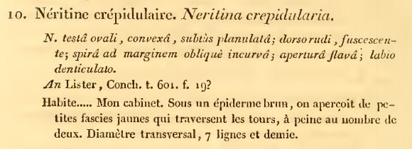

接著讓我們進入主題!台灣圖鑑大部分的圓舟蜑螺學名都是參考2000年出版的「日本近海產貝類圖鑑(Marine mollusks in Japan)」。 然而,也有許多人認為圓舟蜑螺與火之島蜑螺為同種,但是圓舟蜑螺究竟長甚麼樣子呢? 讓我們回溯到 1822年Lamarck發表的Animaux Sans Vertebres ,Tome VI, part2, page186的原始學名是Neritina crepidularia。
英文意思為:「Corpus oval, convex, slightly flattened, dorsal side reddish, brownish, the spire is at the margin curved inwards, aperture yellowish, with denticles on the lip.
Habitat: My collection. Under a brown periostracum, one will see small yellow lines which cross the whorls, barely 2 in number.」。
原始文獻對於圓舟蜑螺的敘述非常模糊。唯一可以知道的重點就是粗體字的: 「殼口黃色」。

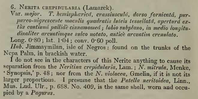

然而Recluz 於1842年時又對圓舟蜑螺重新做了敘述以及評論
翻譯上半段拉丁文的意思:「Shell hemispherical, thick, dorsum fornicated, purple-black, with mosaic pattern of yellow square spots, aperture outwards continuing in pale cinnamon colour, lip sub-plane, in the middle remarkably longitudinally curved, anterioraly crenulated curved.」。
粗體字段落的意思為:「殼身黑紫色,帶有黃色方形的馬賽克狀花紋」。下半段還提到: 「I do not see in the characters of this Nerite anything to cause its separation from the Neritina cerpidularia,Lam.; N.mitula, Menke(帽貝蜑螺), ’Synopsis,’ p.48; nor from the N.violcea, Gmelin(寬口蜑螺)… 」。
中文意思為:「我看不出來圓舟蜑螺的特徵與帽貝蜑螺(寬口蜑螺的同種異名)有甚麼差別」。由此得知,圓舟蜑螺跟寬口蜑螺很相似!
到這邊為止,大家有沒有想過一個問題? 在火之島蜑螺發表的前一年Recluz就縝密查證以及比較過圓舟蜑螺的特徵。那麼,圓舟與火之島同種異名的可能性又會有多少?

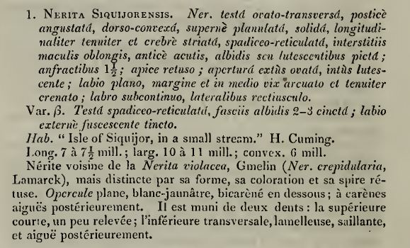

再來,我們來看看隔年的火之島蜑螺的文獻內容
英文大概翻譯為: 「Nerite, corpus oval-elongate, dorsal side convex, overhead forming a plate, solid, with axial lines and folds, reticulate, interspaces between pattern inflated, anterior sharp, white or yellowish color, 1 and 1/2 whorls, apex flat, aperture semi oval, yellowish, lip flattened, border at the middle bended and granulated, lip not continuing, ......
Nerita close to Nerita violacea, Gmelin (Ner. Crepidularia, Lamarck), but distinct by its form, its coloration and its depressed spire. Operculum flat, white-yellowish, bicarinate below; with acute carinas posteriorly. It has two teeth: the uppermost one short, weakly high; lowermost transverse, lamellate, prominent and posteriorly acute.」。
粗體字段落的意思為:「垂直線與網狀花紋的空隙是膨脹的;殼口黃色;有兩個齒(此處指軸齒兩端),上齒短且微高,下齒呈明顯的薄片狀,尾部尖銳」。值得注意的是,當年Recluz就已經把圓舟蜑螺列為寬口蜑螺的同種異名了。

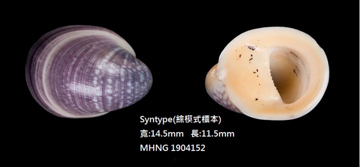

接著,就讓我們來看看圓舟蜑螺的綜模式標本Syntype吧!
看了圓舟蜑螺的綜模式標本後,發現軸齒兩端平滑(與火之島的敘述相左)。不僅如此,也證實了Recluz當年對圓舟蜑螺的論點以及把火之島蜑螺列為不同種的特徵等…,都是正確的。

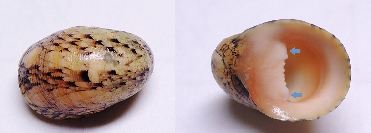

台灣火之島蜑螺的標本如下(產地皆為新竹):
同樣是橘色殼口的火之島蜑螺,但是白色花紋有膨脹的現象,而關鍵的軸齒兩端都呈明顯片狀凸起(灰色箭頭處)。

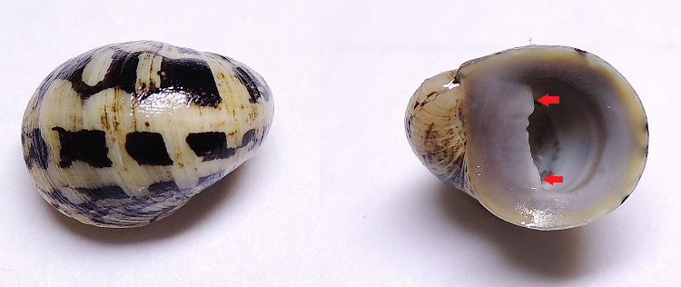

同樣是方型花紋的火之島蜑螺,但是殼口為黑色,而關鍵的軸齒兩端也呈明顯片狀凸起(紅色箭頭處)。
結論:圓舟蜑螺是寬口蜑螺的同種異名。也就是說,從頭到尾,圓舟蜑螺與火之島蜑螺本來就是不同種。既然是不同種,那麼就沒有同種異名問題。因此,台灣、日本、菲律賓標示為圓舟蜑螺的種類都是火之島蜑螺。然而,除了殼口顏色、花紋之外,區別火之島蜑與寬口蜑螺的關鍵就是軸齒兩端的凸起狀況。
一張圖 勝過千文萬字
這標本 分明就是寬口蜑螺
有這張圖 一切就都水落石出了
顏同學 挖掘資料的功力真是強啊 這就叫'一槍斃命'

'軸齒' 我們又稱'內唇齒'
